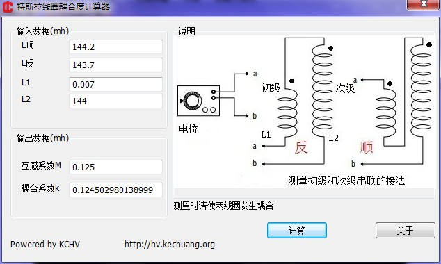

特斯拉线圈耦合度计算器
phpskycn2016/06/06高电压技术 IP:浙江
source: TCCDC.h
C++
#include <math.h> double GetMutualInductance(double dLForward,double dLReverse); double GetCouplingDegree(double dLForward,double dLReverse,double dL1,double dL2);
TCCDC.c
C++
//Tesla coil coupling degree calculator v1.0 //by phpskycn 20130717 // //MutualInductance = (LForward - LReverse)/4 //CouplingDegree = MutualInductance / sqrt (L1*L2) #include "TCCDC.h" double GetMutualInductance(double dLForward,double dLReverse){ double dMutualInductance; dMutualInductance = (dLForward - dLReverse)/4; return dMutualInductance; } double GetCouplingDegree(double dLForward,double dLReverse,double dL1,double dL2){ double dCouplingDegree; double dM; dM = GetMutualInductance(dLForward,dLReverse); dCouplingDegree = dM / sqrt(dL1 * dL2); return dCouplingDegree; }
bin:
attachment icon KCHV_TCCDC (1).zip 834.53KB ZIP 218次下载
