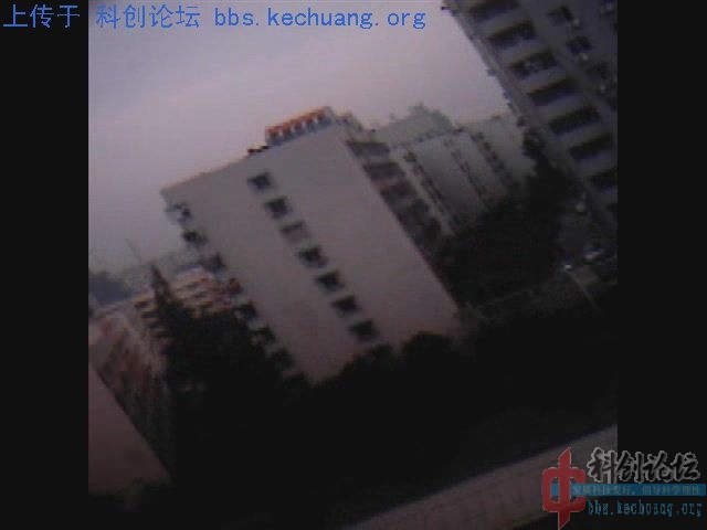

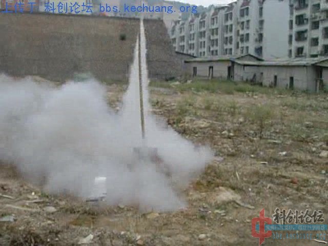

这回我可是豁出去了,一台MP4…… 该火箭重约2KG 用导火线点火 伴随滚滚浓烟,火箭笔直冲向天空!! ------------------------------------------------------------------------------------ [attachment=13932] [attachment=13933] 接下来是MP4的画面,阴天效果很差。凑合着看吧。顺便悼念一下MP4……
屏幕损坏…… [img]XXXXXXXXXXXXXXXXXXXXXXXXXXXXXXXXXXXXXXXXXXXXXXXXXXXXXXXXXXXXXXX [img]XXXXXXXXXXXXXXXXXXXXXXXXXXXXXXXXXXXXXXXXXXXXXXXXXXXXXXXXXXXXXXXX [attachment=13934] [attachment=13931] [img]XXXXXXXXXXXXXXXXXXXXXXXXXXXXXXXXXXXXXXXXXXXXXXXXXXXXXXXXXXXXXX ------------------------------------------------------------------------------------- 因为发动机设计问题。导致刚起飞没多久就发生喷嘴脱离……再加上用竹竿做发射架。。摩擦很大。在加速段损失很多能量 飞行高度才40米左右 [img]XXXXXXXXXXXXXXXXXXXXXXXXXXXXXXXXXXXXXXXXXXXXXXXXXXXXXXXXXXXXXXXX [img]XXXXXXXXXXXXXXXXXXXXXXXXXXXXXXXXXXXXXXXXXXXXXXXXXXXXXXXXXXXXXXXXX 尾部着地,PVC外壳断成两节 [size=1]93:囧,图片上传到我服务器了,直接看吧。。[/size] [size=1][fly]Images Powered by RFFTP V1.1[/fly][/size]

里面装了一堆的沙土做配重
发动机自重有大约500g,加上PVC外壳和MP4,差不多2KG了
18年9个月前IP:未同步
21335
发动机是KNDX,燃料300多g
40mm 普通白色pvc水管
长度18cm
喷嘴1cm 水泥 ,环氧树脂黏合
发动机总长约20cm
火箭体是50mm的pvc水管,长1米
但是这个发动机点火后空烧太久。把pvc给烧软了,于是升空后发动机喷嘴脱离

对。就是单靠运气。。那个MP4只摔坏了屏幕,其他功能正常。。。。
