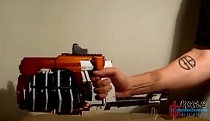

找视频的时候发现的一个不错的网站(不知道能不能发链接。。。不过要翻墙。。。)看了才知道原来可以做的这么美!!!!!!!发点图片,给自己点信心,争取寨一个出来~就不枉费花费的时间和精力了。
此款参数为:
4 staoes. ca.500J.total
projectiles: 5.6X16mm steel
powersource: 4x18650(Stored along the bottonline)
Mass: Around 3.5KG/7 pounds
Wavelength: 1064nm
Output: kilo-watt range
Charge time: 5 -7 sec
One pulse per minute MAX !
Range without focusing optics: 10 - 15 feet
With optics attached: 3-5 inches / 70-80 mm (melts tungsten!)
Caution: HIGH VOLTAGE ! Energy storage stores 80-100 Joules @ 350-400 Volt !
PARTS AVAILABLE, kits on request !
Optional components:
Picatinny rail, visible green aiming laser, air-cooling, focusing optics
Estimated assembly time: 30 - 40 days
