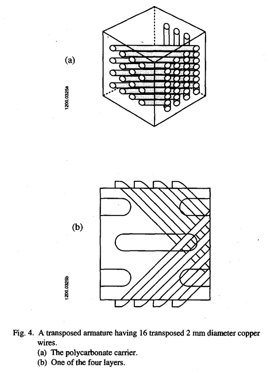

调位电枢的实际结构:
attachment iconMulti-Point, Packed Wire, and Monolithic Armatures.pdf447.36KBPDF66次下载预览
